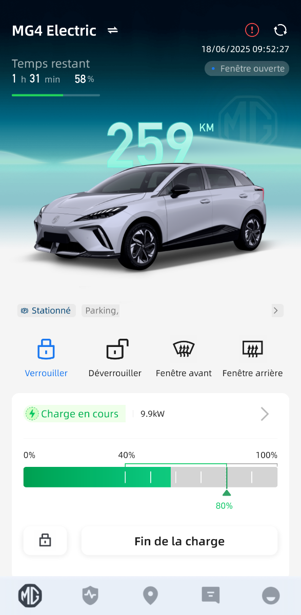

Mise à jour iSmart version 3.1.0
"Smarter dashboard design for a more immersive experience:
- More visible: Increased vehicle status information & one-touch controls
- More immersive: Real time charging info shown directly on the dashboard
- More optimized: Improved logic of registration & login process including a step by step guide
This update also includes several bug fixes. "
Elle est belle !
Et très "temps réel"...
