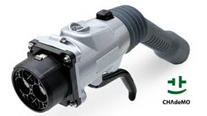

-Sur borne Chademos si options.
images?q=tbn:ANd9GcTN1HKUGvQBjvpr7OmK8EdT3SVGw3zwg2IyVhiuvi0S_VDIRAAVnA
À 50kW max
