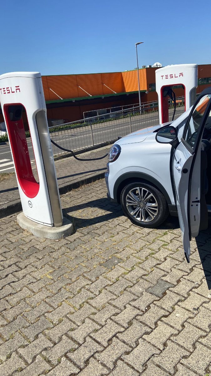

  6. Un utilisateur sur un groupe Facebook anglais l'a fait: Professional conduct, loading first time at Tesla, worked fine, I downloaded the Tesla app, but unfortunately Leapmotor cars are not included for Tesla chargers. you will put your card details in the app for payment. If this works You join Tesla stall put the charging hook to the T03 and over the screen you tell the car 80%. In the Tesla app you will tell the Chargernumber and start loading. You don’t need to tell the app what car it is. Better than other apps btw.
  7. https://www.facebook.com/photo/?fbid=10076671375704604&set=gm.1364004288199615&idorvanity=1344206133512764
